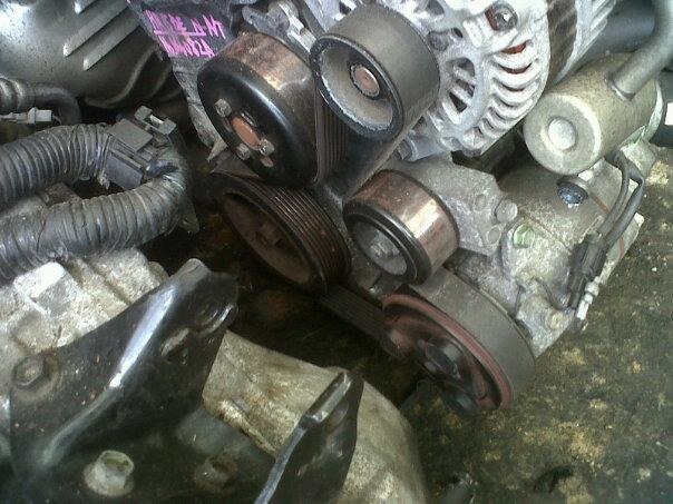

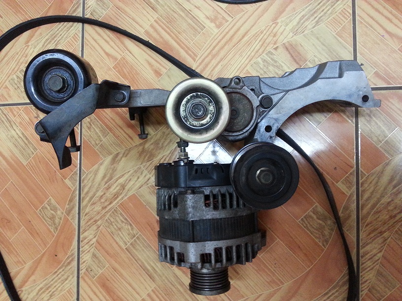

Postby Densil » March 7th, 2013, 3:00 pm
here are a few pics i took of the parts i took off.......if anyone needs an alternator.....i got one...lol....my pulley was the wrong width.....as you can tell from the picture....as i said before..this is bolt for bolt "conversion"...very simple and you can do it yourself once you can use a spanner and socket set...lol

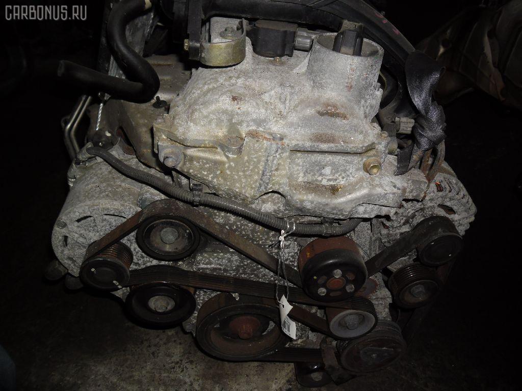

This is what the belt layout used to look like
p.s not my engine.....got this pic online..lol
front view
side view

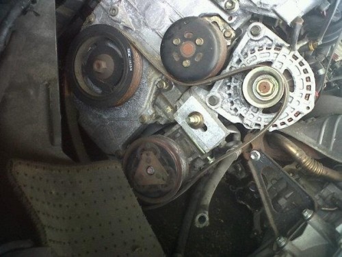

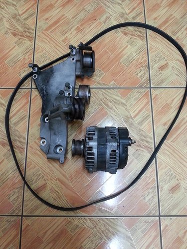

IvanTerrors
Posts: 497
Joined: July 25th, 2007, 8:53 pm
Re: Tiida 2006 e-4wd Generator Problem
Postby IvanTerrors » April 28th, 2013, 7:58 pm
One is of the bracket and the next one is of the manual tensioner.
