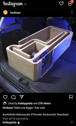

I really came to post this pic from hexibass

Postby Brian Steele » May 9th, 2023, 8:04 pm
sMASH wrote:I will dedicate some time to design a t line, snd tryyyyyyyyy to model it in horn rsp. But that software bummies me.
This might help... http://www.diysubwoofers.org/tls/
Hexibase's designs look interesting, but I don't agree with some of the stuff he says ("3rd order" subwoofer alignment? Really?) and the designs look overly complex. For example, that picture you posted, I'd just use two drivers in a vented or TL design instead, fix any issues with DSP, and enjoy good bass and better integration with the midbass drivers in my car.
