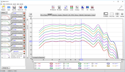

Postby Brian Steele » August 17th, 2017, 10:05 pm
Brian Steele wrote:Good THs give an effortless-sounding bass.
And here's why it sounds effortless - here's the response of my TH with its new 3012LF-4 driver. I used my car amp for the test, so the response is being filtered above 100 Hz or so. The HornResp sim of the TH with that driver says that the driver would run out of Xmax in that TH at 33.5V (i.e. 280W into 4 ohms) in its passband. I tested it up to 40V (400W into 4 ohms) and I'm fairly sure that the "compression" that's visible in the 40V test has more to do with the mic than the TH. Notice however that the response remains virtually identical at lower levels? I'm sure that's what contributes to my impression of that "effortless bass" sound.
