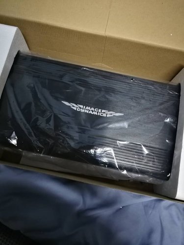

Postby infinite_RPM » March 10th, 2019, 5:56 pm
Id i5800, the amp and the dsp actually have the same brushed metal finish so I'm studying to make a nice amp rack and show them off..
Will proceed with big 3 and other wiring installation when I get pay later in the month.. will update with pics
