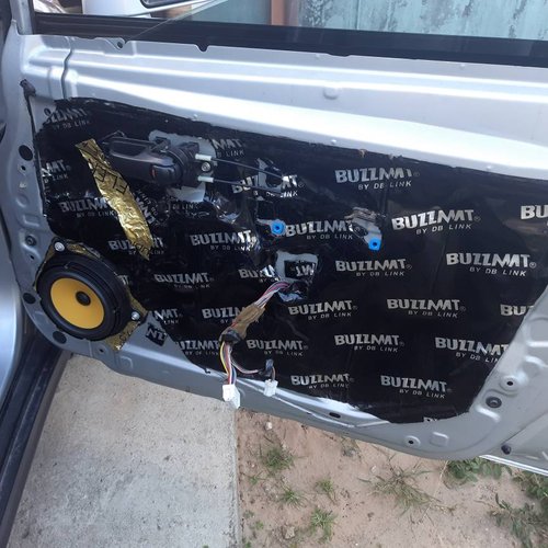

Sounding rellllllll nice. Thanks fellas rovin & mr. Timelapse...question though, the box says these rated 50rms. Is that together or each?

Yeah Rovin Buzzmat is rel value for money ting

i cant recall if he did buy d Buzzmat from me a while back but yes i do have it if not d lowest then among d lowest price in d country $125 for a 18x32 [4 sqft] sheet, its a good solid product at an affordable cost
he did get d nissan door adapters & bnib jl c1 comps from me just saturday gone so thanks for d support
freq range in d manual is 48hz-24kz so try 50 & if u find it sounding lil muddy depending on your tuning cut them at 63 - did u go by times or u did it urself at home ? , if u around my area & want me to take a listen feel free to check me

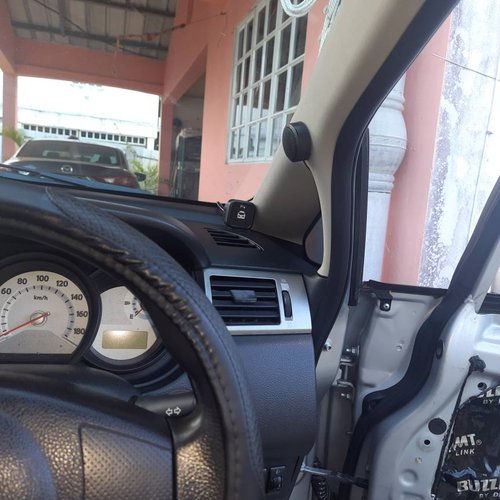

Are you using the deck alone for processing jeramy? Is the tweeter installed like that temporarily? They may require re-aiming.

Yup. Deck alone..the tweeters are indeed temporary placed. They were hurting ears a bit at 0db. Flipped the switch on the crossover to -3db and they sounded alot better

c1 tweeters are metal dome so it will naturally be a bit bright so yea tone it down a bit & it will sound much nicer ....

Fellas, 3m 2way tape and silicone not holding up them tweeters. Any idea on what to use to stick them? Dont want any damage to the panel.

Use outdoor two way and ensure the area is thoroughly cleaned and degreased.

But bmt, If silicone aint holding ya ting, then there's something wrong with your surfaces :lol: Because I tried a test where I had a layer of fresh engine oil on glass, and silicone still stuck to it (albiet not strongly, but still)
meeno what you doing wrong tbh,,, take a picture for us please.
(or it could be that your tweeters just heavy too eh, it may need mechanical mounting)

They are a bit heavy. It slides of an falls off without before the silicone drys

Well then Capitan , Put something to prop it while the silicone drys and cures over a weekend :) And don't use the vehicle until it's good to go :))))))
Also you may need to glue on an extra bracket yes, to get more surface area adhered to the car body to support the tweeter.
While we wait on a picture......What tweeter is it and where is it mounting?

Prep and clean your surface properly. I've never seen that just fall off

This was it, with the 2 sided tape. Its the tweeter that comes with the jl c1s

My tiida has an original tweeter mounting spot there. I would look into getting that A pillar finisher. Clean surface with rubbing alcohol then apply mounting tape, or could try hot glue.

Is this fabric or plastic ?
But yeah hoss, Evo stik/silicone/even hot glue or wood glue would hold this smol tweety boi
Just need to prepare the surfaces and hold it in place while it cures. Yuh overcomplicating it :lol:
Hot glue holding my tweeters in place rn big man ting. Once it's not in direct contact with sunlight/heat it'll last a good while

like everybody already said clean surface & good adhesive will work
on d other hand weather hot these days & if ur ride park up in direct sun for hrs with ur glass all d way up temp inside can get high & cause a possible adhesive fail
if dont want to put a hole screwing them on cause u gonna sell d car in a while then rest tweeter on dash or put d screw hole & when u ready to sell d car put in cheap tweeter to hide d screw hole ...
