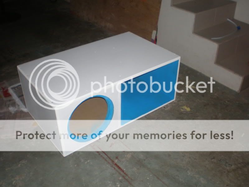

Postby pugboy » April 3rd, 2010, 9:30 am
Coincidence,
I just built one for kicks, I just built a box that somebody already designed for a particular driver, it probably is not optimized for mine (12" Deltapro)
but it is playing quite loud and good to 40hz, not much below but very loud above.
This is the second one I built, the first was Danley TH-SPUD clone, its the big one in the background.
Tapped horns are getting a lot of interest over the last few years, more than any other speaker methodology especially since ported and bandpass techniques are over 50 years old.
Everybody is using the Hornresp program, its been pretty much proven to be quite accurate in modelling and predicting responses, if you check the diyaudio forums there are plenty scientists over there who have built and measured with their fancy test equipment. A guy over there built 4 boxes using 15"'s and says people can feel them a couple football fields away.
I am presently playing the Hornresp program and gonna try doing a proper box.

Postby Brian Steele » April 3rd, 2010, 10:12 am
pugboy wrote:This is the second one I built, the first was Danley TH-SPUD clone, its the big one in the background.
Nice job there. Response might be a bit wobbly in the passband though if the Deltapro's specs are significantly different to the driver used for the original model. What design did you copy?
BTW, is that a Lowther in the background?

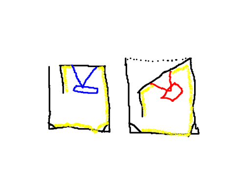

Re: Tapped-Horns for "Gallery Style" bass
Postby ruffneck_12 » August 26th, 2010, 7:08 pm
going slightly off topic
does the red design qualify as a tapped horn?
Brian Steele
Postby Brian Steele » August 26th, 2010, 8:36 pm
ruffneck_12 wrote:going slightly off topic
Probably not.
Postby ruffneck_12 » August 26th, 2010, 10:35 pm
but for a outdoor application, will the red design will be heard at a further distance/more 'spreading' of the sound than the blue design considering that both boxes have the same specs?
- Rovin's car audio -
Posts: 8156
Postby - Rovin's car audio - » August 27th, 2010, 12:36 am
im not a expert on this horn thing but to me that red design just looks like a normal ported box with 45 degree corners & a slanted front - dunno if there will be any benefits from just a slanted front ..... :|
Postby kurpal_v2 » August 27th, 2010, 11:17 am
Might get some sort of loading effect on the straight wall....
