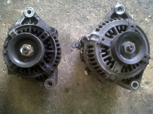

Comparing the alternators, you'll notice the difference in size.
100A unit is on the right...like comparing a grapefruit to a tennis ball ent?

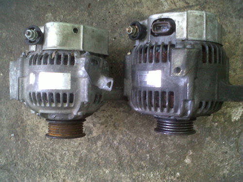

Then there's the orientation of the plugs (shown in pic below). The pin designation is the same (S-IG-L), but it just faces a different direction on the unit.
If your car comes with the round plug, just buy the oval plug for small money in a parts place or from an electrician who might have a cut up harness somewhere. The colour code is the same, so you can solder it in yourself.
You'll also notice another difference (or at least, you're SUPPOSED to notice).
Check the pulleys. They're different. 4PK on the 100A unit and 5PK on the stock unit.
(yes, it's a different alternator on the left this time, I wanted to swap pulleys from an old unit with a bad bearing, then I remembered to take a pic, but too lazy to go back n' get the one I just took out of the car)
Anyway, these pulleys are NOT swappable since the rotor shafts are different diameters. Again, check an electrician who'll usually have old blown alternators to scrap a 5PK pulley from and they'll swap it for u for small money.

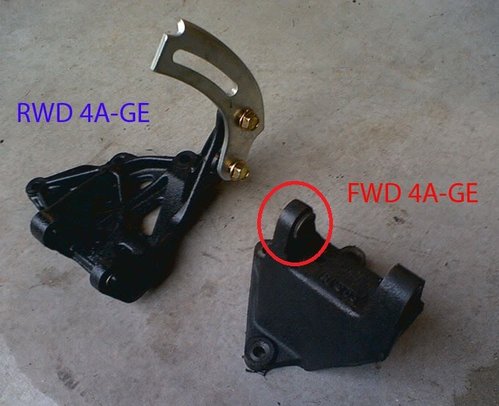

Now, the 20V top bracket needs to swing about a millimeter up for the top of the alternator to bolt in. You'll need to remove the bracket and open up that hole (circled) in the pic. Remove the cam gear cover to get to the lower bolt with a 12 spanner.
The chuck on my drill only opens up to 3/8" so that's what I used and it worked.
