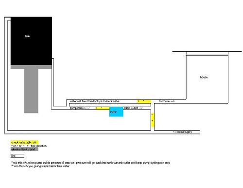

Postby 88sins » April 12th, 2020, 3:49 pm
linton wrote:Back to topic . I've seen some concrete tank stands with one concrete post . Does this work good ? I mean is it safe ?
Will the concrete on its base last as it's exposed to rain. I seen concrete floors crumble when left exposed with steel in it swollen and the concrete shelling out .
more risk of them toppling over than the concrete crumbling. better to build with a proper foundation and corner columns, so it's much more stable & you could just wall it up & have a small storeroom below for pump, tools whatever.
a rough example of what I mentioned earlier.

Postby 88sins » April 12th, 2020, 4:18 pm
@ maj.tom
Decent build, but it doesn't have to be that tall.
As I mentioned earlier, the tank outlet need only be above the highest outlet point in the house, say 12" above your shower.

Postby adnj » April 12th, 2020, 6:16 pm
That is the standard design for a gravity+pump system. With the pump at ground level, running the gravity feed from the tank to the structure at the top of the structure's water column will give you a few additional pounds of pressure at the cost of an additional run of pipe. The feed to the pump stays the same.
Run the elevated tank outlet to the structure.
Add the split on the side of the structure.
Run from the split to the top of the water column.
Run from the split to the pump.
Running the split around the pump is not uncommon but it is suboptimal.

Postby 88sins » April 12th, 2020, 6:50 pm
Only if you plan on turning your pump on and off as necessary. Doing it that way, pump switch can remain on unless you need it off.
Running water out from the top is what's known as a siphon system, that's a whole other kettle of fish.

Postby adnj » April 12th, 2020, 8:01 pm
88sins wrote:Only if you plan on turning your pump on and off as necessary. Doing it that way, pump switch can remain on unless you need it off.
The two systems use similar check valve installs. Perhaps I wasn't very clear. Both systems are set and forget unless there is a power outage. Your diagram is of a design that is ordinarily used for retrofit or when a simpler/easier installation is the objective.
With a top of column gravity connection (including the check valves), flow friction is reduced because the outlets, especially at the top of the structure, typically have a more direct pipe run with fewer fittings when compared to running to ground level and returning to the water column.
Top of column connections usually start to shine on structures of three floors or more where the water column pressure differential is about 15 psi. If it's a single floor, there won't be more than about a 2.5 psi advantage. That 2.5 psi isn't much, but it is usually noticeable if more than one outlet is open.

Postby adnj » April 12th, 2020, 8:17 pm
ScHoolboySoloQ wrote:
I saw there are pumps with waterproof housing so you can put it next to the tank on the stand then just run everything to the house. If you use "gravity feed" from the tank then to the pump at different location wouldn't it starve the pump a bit and wear it out faster rather than just putting it next to the tank on the stand where it getting direct flow from the tank?
For the most part, it won't be a problem either way because the size of PVC used for household plumbing keeps the flow rates to about 20 gpm.
When the flows and structure height increases, some calculations have to be done to address that type of problem.

pugboy wrote:To protect the pump from running and burning on a dry tank you should also install a float switch inside the tank
When tank has water and the switch is floating it allows the pump to run
When dry and hanging it breaks the circuit and pump does not get power.
You will need to run wire from tank to pump to implement a float switch.
What happens if u have a restriction on the suction side of the pump? Check valve from tank lock up for example

you have a problem then but check valves dont normally malfunction that way
if they lock up, they lockup open, eg crud jams and dont let it close

Actually I have met quite a few that stick... Like they didn't open so long the rubber seize on the brass and it refuse to open. Mashup a couple pumps these seizing check valves...
pugboy wrote:you have a problem then but check valves dont normally malfunction that way
