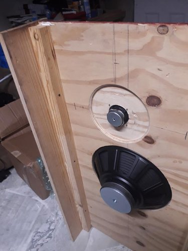

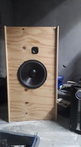

Has anyone ventured into full open baffle systems for home ie. both for mids and bass ?
For the covid I built a copy of the manzanita's which is a proven documented design on diyaudio.
Where this system shines is in the reproduction of songs with acoustical content.
The sweet spot is wide and the soundstage has depth in my listening area.
Pink Floyd Dark Side of the moon is lovely to listen to on this setup.
Rock music is bit a challenge for the manzanita, however I believe that open baffle designs such as
the LX521.4 designed by Siegfried Linkwitz get around this by using a dedicated 8" midbass driver.

^ nice!
The LX521.4 has a really interesting box design

What drivers u end up using and active or passive xo?

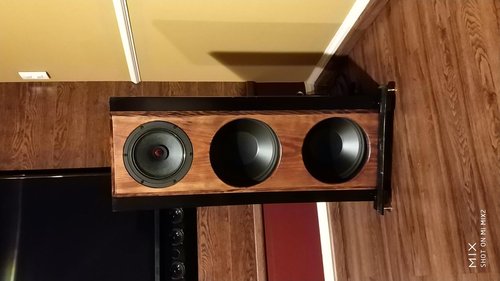

Built a pair of these open baffle speakers a couple years ago.
Dayton full range 8", and GRS 12" open baffle subs. 1.5" MDF Baffle for the bass with pine baffle for the 8" FR
The sound was fantastic. Very detailed sound stage, natural sounding vocals and intstruments. The bass was articulate and true. Listeners to the system ranked them the best sound they ever heard. The realism was out of this world.
I used them in a bi-amp config. NAD 326BEE for the 8" and Behringer 1500 W for the 12" subs. The processing was done with a JL Audio TWK 88 and the source was a Yamaha WXC-50. I have a vast Hi Res collection.
I must say that I thouroughly enjoyed the sound. The music really pulled you into a completely different understanding. I scrapped the system to reconfigure the speakers. The cause being the complication of the final solution. Too much equipment. The subs required alot of power and alot of tuning to get it to sound just right.
Thinking about a configuration comprising a dipole sub, open baffle mid/midbass and air motion transformer tweeter. Still putting some thoughts together though.

I followed the plan for the Ultra version of the manzanita, and used the passive crossover, it might be cheaper to go active but I only have a two channel stereo amplifier being fed from my computer. Going active will also give you a better dynamic range.
https://www.diyaudio.com/forums/multi-w ... oject.html
vifa tc9 <- mids/high
GRS 15PF-8 <- midbass/woofer

That looks pretty good, the downsides I saw is the size and that the speakers need to be at least 3 feet away from the front wall, however when you have them position just right, you definitely can tell.
The dipole idea is not bad, I see the there is a guy who can design ripoles for you once you supply the t/s parameters to him. You can also probably match your open baffle mids to a tline sub - that should be a good compromise or use 18" GW1858 H Frames :)

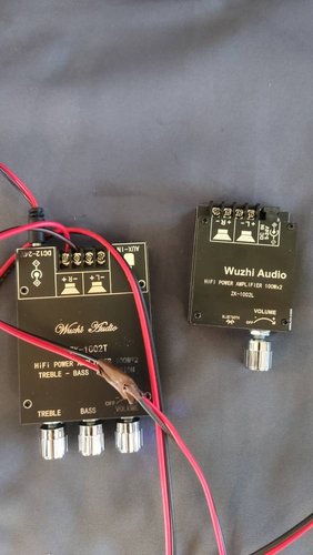

These lil bt amps from Amazon are awesome
Some decent power but you need the 24v power supply

I had a monoblock running an 8 inch sub, I tested it and it did around 63 watts RMS which is pretty good for the footprint. My PSU was the original 19.5 volt that came with the amp.

yeah, they are pretty good, once you match the 4ohm or some high sensitivity 8ohm speakers they are pretty decent
shitty thing there isnt much of a choice in terms of speaker choice--only those pro audio loudspeakers and the other end of the scale--studio z, sound barrier etc
looking at the column type line array set up---8-3 inch, a planar tweeter and a 12 per side
but i will wait till i am going fl or so next year to get the stuff
to ship in some decent dayton, peerless, hivi etc is too costly for the value
getting a pair of silver flute 8s for cheap, but by the time its landed, it will cost around 1000TT
