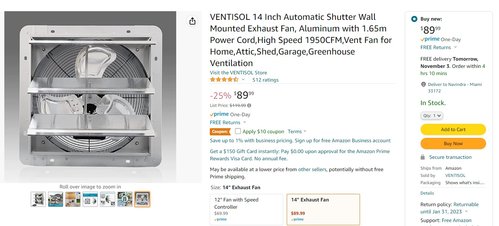

I wonder if installing one of those roof turbines will make much difference
Posts: 29408
Re: Building a house in Trinidad
Postby pugboy » November 1st, 2022, 4:55 pm
they come in 5ft wide rolls so kinda hard to manouvre
an extractor fan will help a lot, I have a solar powered one in my same shed also
you could test out somewhere by putting a powered one like on on eave soffit and see if air temps of the ceiling drops. ideally sucking air from bottom and exhausting up or from one side of the house and exhaust on other side
Posts: 20061
Postby Chimera » November 2nd, 2022, 8:17 am
this looking good yunno
wonder what it sells for locally?
Posts: 29408
Postby pugboy » November 2nd, 2022, 8:19 am
I see a lot of exhaust fans on the market now, they used to be real pricey but not anymore
ones around that size for a few hundred
saw some in a hardware this week self.
Posts: 20061
Postby Chimera » November 2nd, 2022, 10:35 am
which hardware? pariaghs?
Posts: 29408
Postby pugboy » November 2nd, 2022, 11:26 am
i think it was ramlagans balmain
