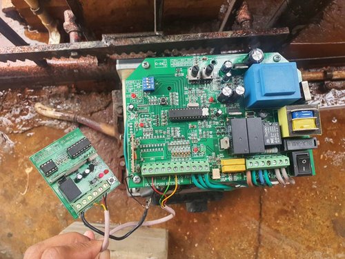

Postby supercharged turbo » April 25th, 2023, 9:24 pm
How do you perform a hard reset on your gate motor?I lost one of the keys and just for the safety factor,I wanna delete all the remotes and program them back.
Its a generic chinese branded unit.

Any model number ? If it's generic it's probably a copy of another popular one with a manual that we can find, steps should be the same
Or if we lucky, we could probably get the manual for it. Just cuz it chiney dont mean it generic all the time eh ;)
Open it up and post a pic of everything.

does it have a built in rf receiver or third party one?

I tried programming it last night and now its only opening from the remote and not cutting off even if the magnetic switch passes infront it.
pugboy wrote:does it have a built in rf receiver or third party one?
3rd party one I think?
Re: Servicing Gate Motors
Postby supercharged turbo » April 26th, 2023, 2:06 pm
Pic for referrence

Small board on the left is a wireless receiver. So at some point the one that your gate came with went bad and that would have been added. (Small receiver on left) Small black button on the bottom right needs to be held until the light starts flashing quickly. Then using your transmitter (remote) you will hold down which button you want to be programmed. The light on the receiver will flash a few slow times which means your transmitter has been accepted. Hope this helps.

odd that the feeler switch stopped working just so, they are manual switches which stop the gate, not much to go wrong there.
that third party board will be wired for power from the main board( should be 2 wires) and also another 2 which basically short the 2 terminals on the main board.
so when remote is pressed and the rf board gets the signal it just shorts those two terminals together which tell the gate to open/close, exactly like how if there was a manual switch mounted which you would press to activate the gate.
best thing to do is disconnect that rf board and hook up a switch and manually operate to see if it is working normally
you need a momentary switch, not on/off
There are many chinese wifi boards now which you can also hook up and use a phone app to activate the gate.
I recently put in one on our gate, uses usb type power adapter and 2wires to the same terminals in the gate board.
it also has wiring for switches to detect if the gate is in open or closed position and can send you phone a message when somebody opens the gate.
I happen to have an odd problem with our gate which was installed this year, occasionally it gets some spurious signal and opens or closes on its own. hence me installing this phone app to be able to close gate remotely if I see it open on my cameras

... if you're trying to clear all codes, try pressing the learn button eight times.
Postby supercharged turbo » April 26th, 2023, 8:23 pm
adnj wrote:... if you're trying to clear all codes, try pressing the learn button eight times.
Will try this
