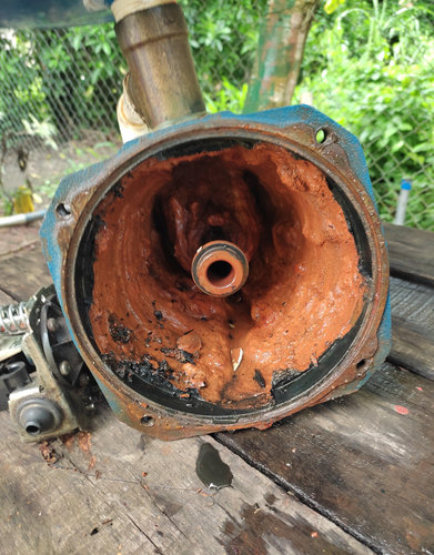

Anybody ever serviced the pump side of the Pentax cam 50? I replaced my shaft seal successfully due to a leak and I must have loosened up some gunk as the pump now won't build beyond 30psi. I had to adjust the pressure switch to cut off at same. No leaks cuz pressure holding once switched off. The impeller is clean. I want to go behind the diffuser but not sure what's in there to break lol. I saw the diffuser selling so breaking it to come apart is no problem. Does the straight pipe come off? Can a clog there be the issue? Anything specific to look out for?
Posts: 29408
Re: Which residential water pump to buy?
Postby pugboy » June 18th, 2024, 7:43 pm
there is nothing behind it
it usually breaks when you try to knock it out
the straight piece i am not sure about as it seems fixed into the body

alfa wrote:Anybody ever serviced the pump side of the Pentax cam 50? I replaced my shaft seal successfully due to a leak and I must have loosened up some gunk as the pump now won't build beyond 30psi. I had to adjust the pressure switch to cut off at same. No leaks cuz pressure holding once switched off. The impeller is clean. I want to go behind the diffuser but not sure what's in there to break lol. I saw the diffuser selling so breaking it to come apart is no problem. Does the straight pipe come off? Can a clog there be the issue? Anything specific to look out for?
Pentax known to clog the pressure switch hole with rust. Incorrect pressure readings as a result. Pump builds pressure but the switch does not see it. Doesn't hurt to clean that hole first.

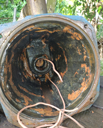

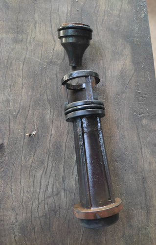

Got some measure of success in fixing the pump. I removed the diffuser and cleaned the inside which was full of rusted out metal.
Most importantly the opening to feed the venturi tube was rusted shut. Cleaned it out and put back in service. However tiny bits are still coming loose and plugging the impeller which is the closed type. I'm at least getting it to build to 40psi which is fine for now. Will wait a week or so again and give a final cleaning on the impeller
Before
Venturi tube assembly
Venturi tube opening now clear

how did you remove the straight pipe in centre?
those rusted flakes are gonna be a problem
you could try putting a hammer drill to chip out

pugboy wrote:how did you remove the straight pipe in centre?
I used the flat blade end of the hooky thing used to crank scissors jacks to pry out the diffuser. From there the straight pipe pulls out by hand and the nozzle comes out with a pair of needle nosed pliers

you just tap it back in and it stays?

pugboy wrote:you just tap it back in and it stays?
Yeah, it's got O rings to help seat

the one i tried to take out wouldnt budge and i was afraid i would break it
have an old one to take apart soon

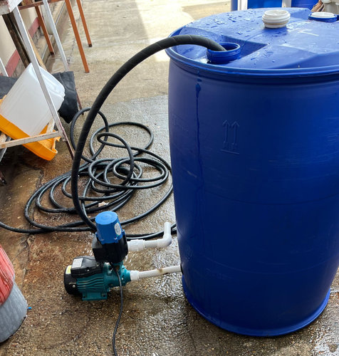

what’s the experience with the small leo pumps?
i have a location with perennial low pressure
filling a 1000gal goes at trickle at the 8ft fill valve
i see they have a smarthead which cuts off when it senses no supply pressure and automatically comes back on
i wanna fill a blue barrel from wasa which is shorter
then feed into a small leo which will pump into the big 1000 gal
Posts: 10747
Postby 88sins » June 20th, 2024, 9:59 pm
pugboy wrote:what’s the experience with the small leo pumps?
that will do the job
Or
Use a 350-400 gallon tank instead., filling from below.
That will hold a lot more water than a barrel and fill the big one faster with a bigger reserve.
Posts: 29408
Postby pugboy » June 22nd, 2024, 3:21 pm
got a used leo pump with smarthead and tested this idea out
barrel fills to about 10” which put enough pressure on the smarthead intake water sensor to believe there is water supply and switch on to dump the 10” of water from the barrel to a taller water tank.
when it runs dry the smarthead safety cutoff works and comes back on as wasa trickle fills back the barrel.
ideally a wider barrel would be better to hold more volume and less cycling.
location has very low pressure for most of the day, prob 5-8psi so a hose produces volume at floor level but held above 5ft just trickles.
