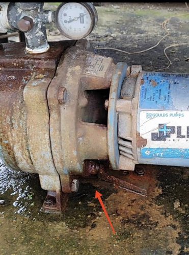

Re: Help---Goulds Water pump prob (vid)
Postby X_Factor » August 13th, 2024, 9:26 pm
That cast iron part cracked by the bolt while re assembling after changing the shaft seal
Does anyone know where i can get that part?
