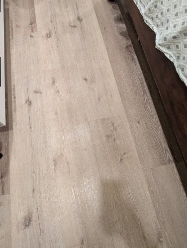

Posts: 18955
Re: Building a house in Trinidad
Postby Dizzy28 » October 21st, 2024, 10:58 am
viedcht wrote:Yeah that durability worry is my concern, don't want to shell out $$ for spc/laminate only to go back to tile. And hardwood will cost me 3X because of the woodworking, and me eh have the dedication to that maintenance nah. Feel tile and done.
I have spc flooring in two rooms. Both installs were on tlile so the existing floor was good quality and level.
My son's room has had The flooring for three years and my bedroom for one.
It is holding up well In both and my son one get real jamming. It's crayons, paint, toy car tyres, all kinna thing and wipe and clean and it good.
My room below. There is a king bed, TV stand etc on it and it hasn't scuffed up.
