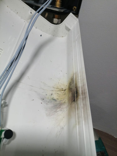

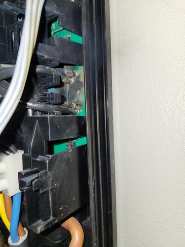

Ttec hit meh for 6...some neighbours suffered more losses than me. Going through the 9 yards of getting compensation atm.
Item: steilbel eltron dce10
eitech
Posts: 3629
Re: WTK Tank or Tankless Water Heater
Postby eitech » August 10th, 2025, 8:27 am
What happened there?
Posts: 33221
Postby shake d livin wake d dead » August 10th, 2025, 9:30 am
Recently we had serious electricity problems... Came back with quite a few surges... My surge protector in the panel was blown together with the water heater.
Other people lost
Gates
Garage doors
Refrigerators
Down to the street lights(newly installed) get licks too
