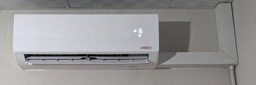

pugboy wrote:i see pricesmart have back the 12k lennox for $2600 or something
what’s the verdict on these units ?
i need a small unit for a little room
I have a 12k Lennox which is just over two years old and a 12k Green Energy making 6 years this year. The Green Energy to me is the better unit..seems to cool quicker and is quieter and it's in a bigger room as well.
The Lennox has seemingly much more features though but I don't use them.
But I mean 2600 is a good price. Think I got mine a bit cheaper two years ago but only because my sister's ex husband sourced it and he got a dealer price.

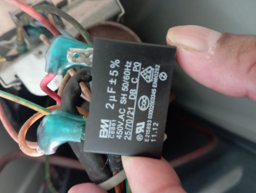

What could cause ac to make ice and blow very cold regardless of the temp setting? Unit was serviced and gassed up recently and filters are clean.

trinigamer wrote:What could cause ac to make ice and blow very cold regardless of the temp setting? Unit was serviced and gassed up recently and filters are clean.
If the evaporator fan is blowing slow due to the settings on the remote or the fan capacitor can be failing, the unit will not be moving the cool air effectively and therefore the coil will freeze up. Also if the unit has a refrigerant leak, the coil will get colder than usual at a point and freeze. Finally it could be a stuck compressor relay which will cause the condenser to keep running while the evaporator is off. Easy to diagnose this by simply turning off the unit with the remote and going outside and see if the condenser running.
Posts: 23834
Re: What the Best Split level AC Units...Carrier LG, Panasonic?
Postby nervewrecker » March 7th, 2024, 6:07 am
I think you referring to the pressure temperature relationship of the refrigerant. Units are charged to a pressure that corresponds to 5 degrees C or 40 degrees F, below that it approaches the freezing point of water when the refrigerant charge gets cold and decreases in volume. If it is slightly undercharged the temps will be close to or at the freezing point of water.
Systems where temps are designed to be sub zero have a cooling cycle and defrost with a heating element and defrost thermostat to melt accumulated ice on the coils to maintain air flow across it.
Can be improperly placed thermostat, relay contacts welded closed, blower fan speed too low among other things.

Postby trinigamer » March 7th, 2024, 9:11 am
nervewrecker wrote:
Yeah I took off the unit using the remote and the inner unit turned off but the outer one was still running.

Fellas, I have an A/C problem for awhile now, everytime I use the remote to turn off the A/C the condenser outside still remains on. I have to climb up every time and unplug the AC plug from the wall in order for the condenser to be turned off. I was already given advice by someone of what the problem could be but I would like a second opinion here for those of you who familiar with these issues. Thanks.

I have an issue with my unit as well. It was short cycling and hence not reaching the temperature before cutting off. I noticed that the thicker line that leaves the unit containing the compressor that's outside was iced up.
Could this be that the r410 gas is low?

To answer both persons the relay is stuck on evaporator. You need a new evaporator board or get a new relay soldered onto the existing board.
Posts: 4493
Postby DMan7 » March 7th, 2024, 12:11 pm
jehusaunders wrote:To answer both persons the relay is stuck on evaporator. You need a new evaporator board or get a new relay soldered onto the existing board.
Yea this is what I was told as well especially to get someone into electronics and let them solder it onto the existing board because it will be difficult to find a board for my A/C unit.
Its not difficult to do, its 4 pins to un solder and solder back with a new relay, basic soldering iron will work
I've done it few times

Postby trinigamer » March 7th, 2024, 1:12 pm
Is this it?, has three pins.
Will call an ac tech, I doh mess with electricity too much.

That’s a fan capacitor. The relay is a black box with two wires connected and it’s on the board itself.
