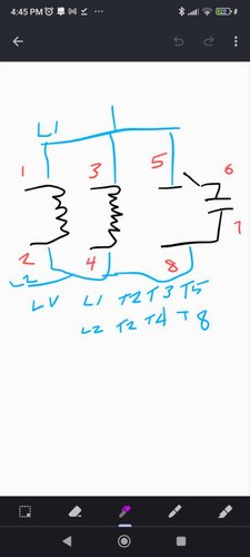

can anybody tell me how to test a single phase and 3 phase motor with a megger. I cant seem to understand youtube vids. I get the basic principles where a coil will have a resistance and the direct shorts but the numbers on the motor wires confusing me

ruffneck_12 wrote:
Richard Coer de Poulet wrote:can anybody tell me how to test a single phase and 3 phase motor with a megger. I cant seem to understand youtube vids. I get the basic principles where a coil will have a resistance and the direct shorts but the numbers on the motor wires confusing me
You have an example of this?
so the single phase motor have t5, t1 and t3 to l1 then t8, t2 and t4 to l2 how would i megger this ? using the red and black leads? thanks
One lead goes to ground—the other to the winding terminal. Run your test—repeat. Resistance testing doesn't care about polarity.

nervewrecker wrote:First off, whats a megger?
Has the motor ever run with this configuration?
Seems kind of odd to me.
Was this the as found condition (meaning it was found with this connection scheme in a not working state and you are attempting to perform an insulation resistance test "meggering" in an attempt to diagnose whether the motor is good when the connection scheme may be the problem)
Here's how I would tackle the issue.
Firstly look for a nameplate on the motor in the hopes you can get a schematic.
If you can get a schematic it should denote the internal configuration wrt the Tx numbering scheme.
If you can't get one you have to attempt to use your meter to deduce the internal config.
Way I see it is T1 2 3 4 5 8
T1 & T2 (possibly one coil)
T3 & T4 (possibly other coil)
T5 & T8 (possibly capacitor)
You begin by putting your multimeter in resistance measurement mode
1. Ensure device (motor) is unplugged/isolated before interfering with anything
2. Place black lead on T1
3. Place red lead on T2 and look at meter for a resistance value (typically a few ohms 3-10 ohms maybe). If it reads a value as indicated you have identified one coil. If it does not keep black lead on T1 and test between T3, then T1 and T4, T1 and T5, T1 and T8.
Once u get a low resistance it indicates this is a coil.
4.Do same until you identify 2 coils (eg T1 &T2 one coil, T3 & T4 one coil)
That should be 2 pairs of wire .
5. By process of elimination the last pair should be your capacitor.
Measure resistance across last pair (should be high MegOhms or high kilohms) this would indicate possible capacitor which can be confirmed by placing meter in capacitance mode
When meter is in capacitance mode measure across suspected capacitor pair of wires and you should get a microfarad reading.
For a single phase motor to work one coil needs a phase shift this is accomplished by connecting one coil directly across mains and the other in series with the capacitor and mains (creating the phase shift).
How you explained 3 of the "T" connections going to line and another 3 going to neutral to me makes no sense (if it is configured how I assume it to be)
If you confirm via measurement the config is as above. If connected in the scheme below it should work
L1 and L2 are obviously your single phase line input connections.
Bai you sure that's single phase?
Because
Unless I forgetting that you can connect up a three phase to run single phase without a capacitor or anything extra?
Or if this motor just labelled their unit like that? Meeno.
But anyhow, take note of how everything is connected, then disconnect it and test each coil/winding separately. Polarity wouldn't matter here.

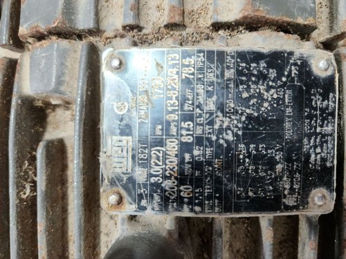

Post the nameplate and coil diagram if there's one available please.
Because
Yes its a single phase with a capacitor

Re: Energy Sector Thread - Operators, Engineers, Technicians Et Al
Postby Richard Coer de Poulet » July 14th, 2023, 9:12 am
Because
and this pic is the 3 phase thanks
Supra GT-FOUR
Posts: 255
Joined: April 30th, 2004, 10:46 pm
Location: Mango Tree
Postby Supra GT-FOUR » July 14th, 2023, 4:57 pm
The motor is dual voltage
The capacitor is in series with a centrifugal switch. This is the 2 configurations.
Your 2 coils are
T1 & T2 coil 1
T3 & T4 coil 2
T5 & T8 start/run cap in series with centrifugal switch.
