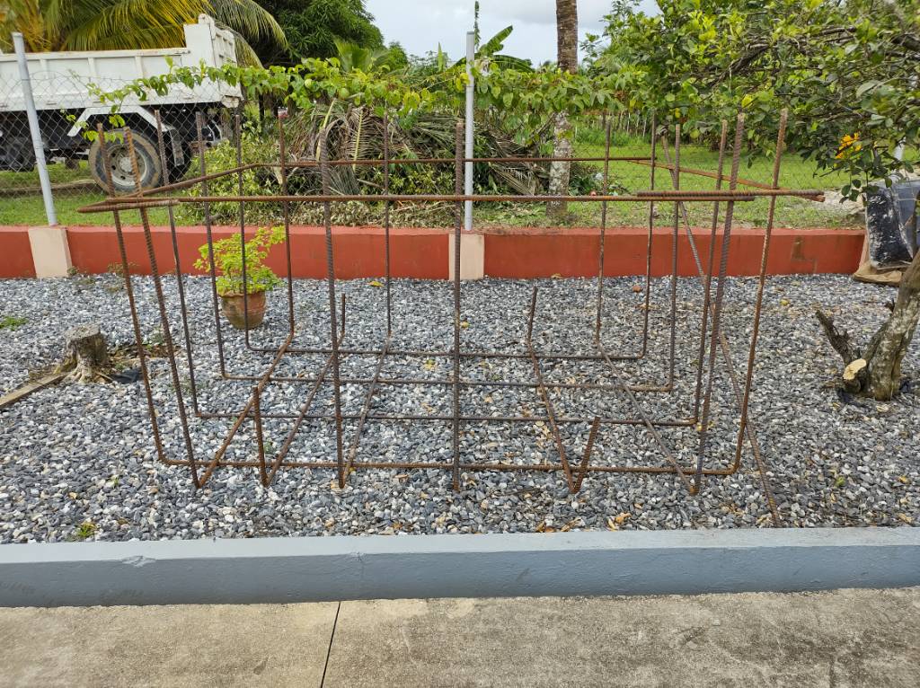

First round of pics for the septic tank work.
Pump sump base made.
Septic tank Lids framed up and ready to cast.
Steel work bent for septic tank.
Line from existing septic tank identified and trench cut across the top of the existing tank to allow for extending the line to the new system.
Perforated pipe on site for lines from soakaway into rubble drain (6") and for a higher rubble drain to handle surface water (4"). Geotextile fabric onsite for lining the soakaway and rubble drains.
Sulphur resistant cement ordered from TCL for use in all areas where sewage and black water are/may be.
Sump pump purchased for interim use is dewatering holes as required. Will be repurposed as effluent pump after.
Backhoe was planned for today but didn't proceed due to weather. Hoping to excavate on Friday once weather is decent.

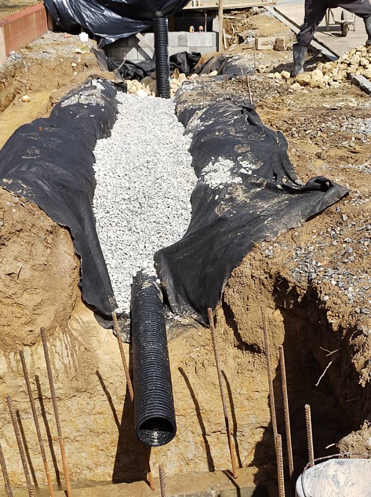

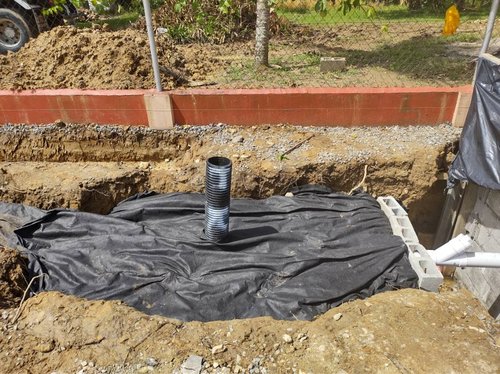

Second round of pics. The first is the hold for the new cesspit.
The second shows the view from the cesspit to soakaway and trench for rubble drain.
The third is the lining with geotextile fabric.
The fourth is the soakaway.
The last is the line up of pipes from cesspit to soakaway and then to trench and pump sump.
Posts: 29410
Re: Building a house in Trinidad
Postby pugboy » July 31st, 2021, 11:21 am

No pugboy.
You can't see it in pic but all the lines are lower that the previous one. We know the depth of the line to the existing cesspit so the outlet line from the cesspit is lower than the I let line. And the line from the soakaway to the rubble drain is lower than the outlet line from the cesspit into the soakaway.

The line to the sump is lower than the line from the soakaway and it's graded to the sump. There could be some runoff from the soakaway which enters the sump for discharge.
Ideally, the system should allow for percolation to the surrounding earth. The soakaway ought to purify the water and allow for seepage. If the soakawy gets filled with water, then runoff from the soakaway would go into the rubble drain which should allow for further purification and seepage.
If the system gets inundated with water, for example in heavy rainfalls (which was the issue with mines which prompted this work) then the rubble drain will channel water to the sump for discharge.
I consulted with someone at WASA's watewater section who advised that this is a suitable system.
The vertical line in the soakaway is for inspection and as a cleanout port. That is peforated pipe so if the entire system should back up (hopefully never given how its constructed), the truck can empty out the soakaway as well.
The black corrugated lines are all perforated pipe.

More pics.
The soakaway filled with boulders.
Rubble drain filled with 3/4" stone.
Outlet line from septic tank to soakaway set in place.
Trenches and soakaway covered with geotextile fabric.
