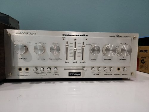

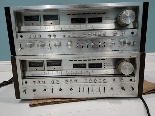

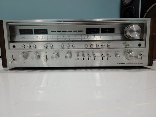

Good Night Everyone,
Looking for someone who conducts repairs on Vintage Audio Home Receivers
Typical Clean, Deoxit, and Recap.

Postby SR » August 8th, 2022, 6:12 am
Sanch Electronics in St Joseph

Postby rollingstock » August 8th, 2022, 8:20 am
wana-B-racer wrote:Good Night Everyone,
By chance do you need a kidney?
