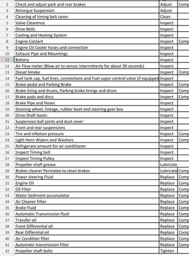

Finishing up my 100k km service over time
Changed air filter; was too lazy to clean the inside and outside of the housing.
Cost
Previous total - $1545
Denso Air filter - $225
Current total - 1770

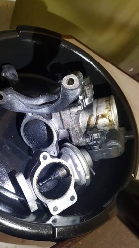

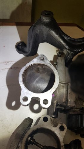

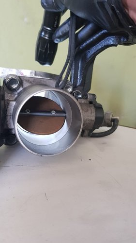

Did a intake/egr clean and injector service by ryotech performance this weekend..big difference..van is way more silent and runs better and quieter..definitely recommend given the shite diesel we getting...service costed $1000

Postby *KRONIK* » March 9th, 2020, 7:12 am
Yours wont be too bad tho, you dont have EGR.

Postby *KRONIK* » March 9th, 2020, 1:30 pm
Lol
Just the vigos
And 2006-2010 local models
They stopped the EGR in the local 2012 > models.

vharripersad wrote:Does anyone have a list of the D4D issues and preventative maintenance or resolution? This would be a nice resource for everyone to have .

Postby vharripersad » March 15th, 2020, 8:14 am
Hello, every 40km service. I tried to put together from different resources. Please let me know if to add/remove/modify any items or any suggestions. I will update and resend .

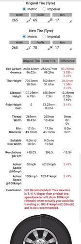

Need some feedback
What is the largest Tyre size you can run on a Hilux without rubbing and without modifying (no lift/no wheel Arch or mudguard modification, no aftermarket bumper)
I'm thinking about getting 265/70/r17 but something tells me it is just a little too big

kamakazi wrote:Need some feedback
thats 31.6x10.4x17 when converted, thats 1" bigger than stock. if using stock wheel, it may not rub.
i runnin 285/60/18 with 2" lift and i still get slight rubbing.

I have 275 65 17 and I get a very very slight rub on splash guard
Will try on 265 70 17 next time before buying

I spoke to someone who is running 265/70/r17 who told me that he has no issues with rubbing at all. I'm really hoping if/when I switch to that size I also have no problems
Posts: 9328
Re: Tech Thread - Toyota Hilux...D4D and all older models.
Postby *KRONIK* » March 20th, 2020, 10:08 pm
Adjust the caster to suit, and if needed, remove the mudguard.
You will be fine after that

That list is pretty exhaustive... I use opportunities to get stuff done
Every oil change is my opportunity to
- drain diesel fuel sedimentor
- change a small amount of power steering fluid
- grease the driveshaft joints
- check suspension components
Drain and refill the trans fluid every 4 oil changes (about 3.5 quarts every 20k km). Don't bother with trans filter as I can't see the benefit.(it's more like a strainer if I'm not mistaken and that can easily be washed)
I change brake fluid when I change brake pads.
Experience from others has informed me that brake shoes last through at least 3 sets of brake pads. I only adjust handbrakes before inspection; because adjustment shifts the brake bias rearwards for a short while and this is dangerous and I need my brakes to be reliable.
I don't adjust/check anything engine wise and valve wise; I don't see the need.
vharripersad wrote:Hello, every 40km service. I tried to put together from different resources. Please let me know if to add/remove/modify any items or any suggestions. I will update and resend .

265/70r17 fits... barely.
No modification required on 2012 hilux
